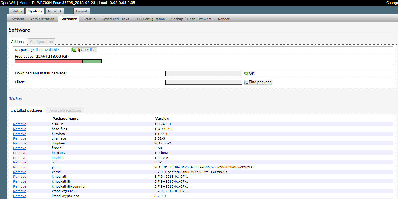

I looked at the space available and I still have ~ 244 kb free, for modules installation.

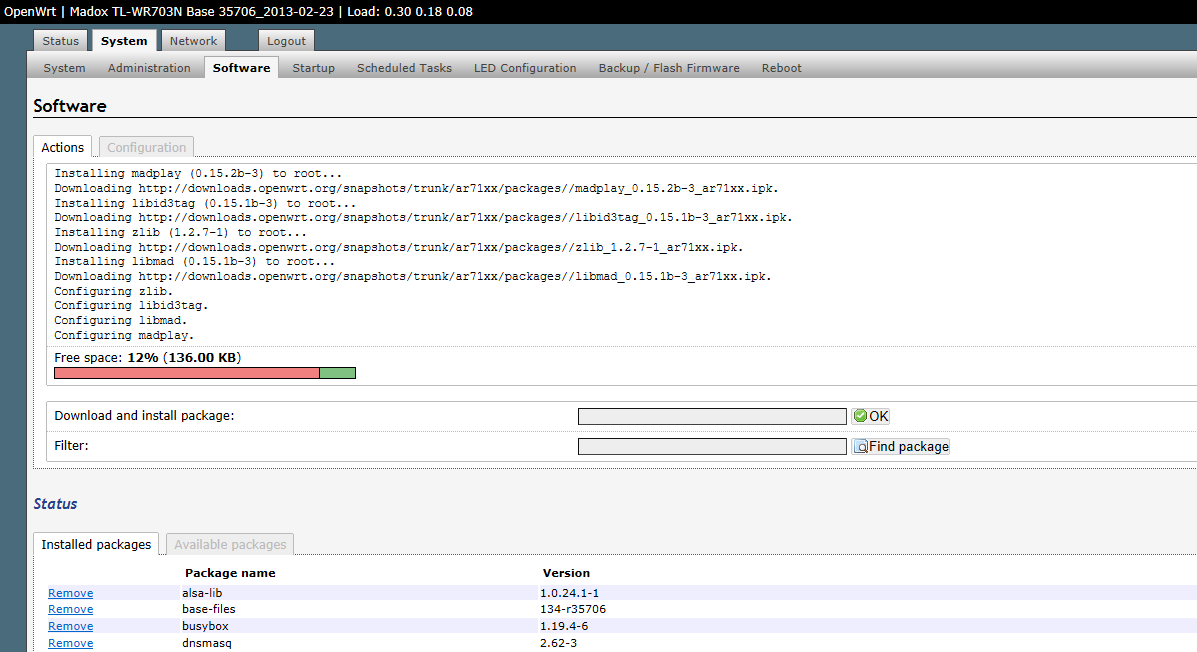

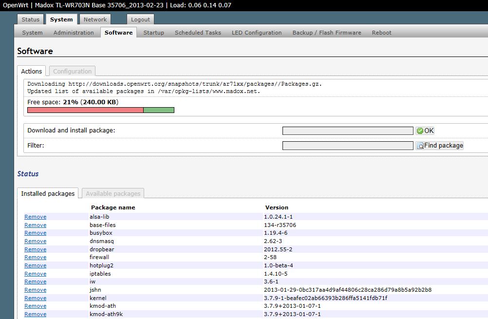

I changed the repository to the one you gave me and I rebooted the router. Initially, it had a little error, probable didn't do the update. I pressed the "Update lists" once again and it did the update. I'll attach 2 prints screens with the messages I got while updating.
It seems the router already had some of the dependencies installed, because I still have room left, 136 kb.

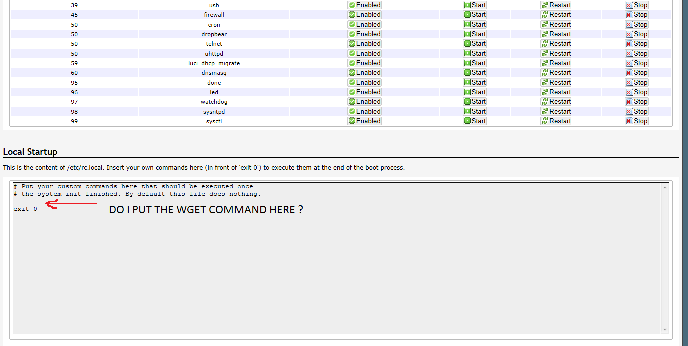

The line with the wget command has to be in the Local Startup, I believe...

I forgot to mention you had to run opkg update. This was because the cache was still pointing to the madox repository. But you figured that one out yourself. Glad you got everything working so far.
But I don't understand you wget question. You never mentioned wget before. Putting it where you made a nice red arrow would run the wget command at system startup, though not necessarily after madplayer has started.
Happy to help.

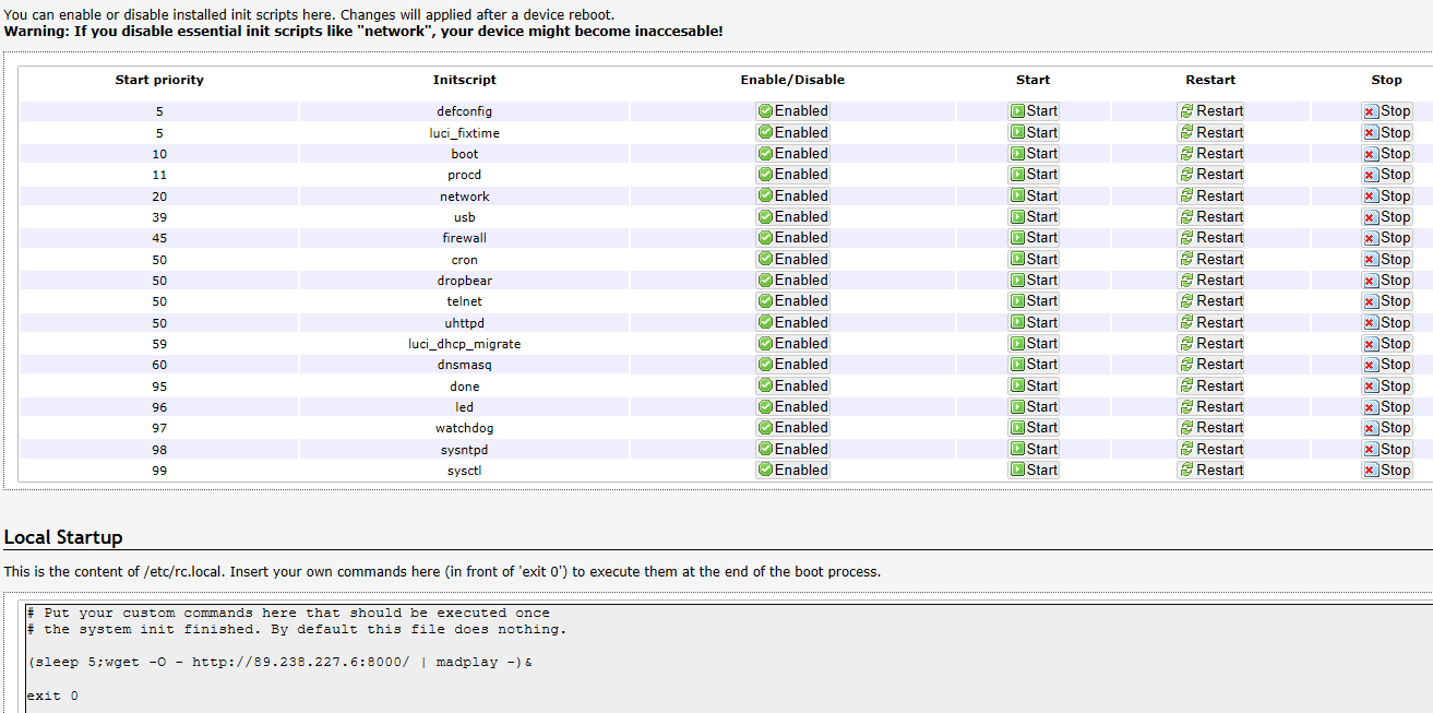

From Openwrt's website, at "USB Audio Support", there's an example of how to configure wget to play an audio stream. Here's the link:
http://wiki.openwrt.org/doc/howto/usb.audio
My understanding is that, if I configure wget to a specific internet audio stream, it will play using madplay, right after it finished the boot process.
So, that will be the place for the wget command...
And something else. How do I make sure that madplay starts right after the boot process ?
Thank you.

madplayer will probably already start at boot. From the openwrt web interface you can enable your application. Otherwise you could do something like '/etc/init.d/madplayer enable'
You can indeed put the wget at the red arrow. However, to be sure madplayer has already started you would probably have to add a delay. Also, the wget command would block the process. So you'd have to daemonise the process. So you would end up with something like:
Code: Select all
(sleep 5;wget -O - http://64.236.34.97:80/stream/1014 | madplay -)&
PS. seeing how madplayer doesn't really support internet-radio. If you plan on using it only for internet-radio, I would suggest using mpd and mpc.

Ok, so I used the code you had in your post, with the delay for the madplay and, within ~30 seconds after I connected this Tp-Link router to the big router, I was able to hear music from radio ! The quality is great, without any clicks or pops. At this moment I'm listening radio thru headsets, but I can tell that the quality of sound is great. I want to specify this, because some other members complained about sound quality using other USB sound cards.
