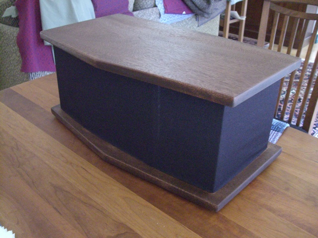

I thought I would post a note to show my Internet Radio build and the iPhone app I wrote to remotely control it. I built a self contained unit with built in 15 watt stereo class D digital amp and speakers without any controls (other than a power switch). If you are interested in how I built the radio's case, check out my website at http://www.craigandheather.net/celeinternetradio.html.
Here is a picture of the finished radio

Now that is cool. By controlling it from an iPhone, iPad, or iPod you don't even have to open up the router, just hack the software (though having the serial port is very handy to make sure that your firmware loads complete). The only thing that I would do different is to build in my own speakers using raw drivers and crossover parts. I think I can make better speakers than what I can buy at RatShack.

Very sleek design. I really like the wood.
