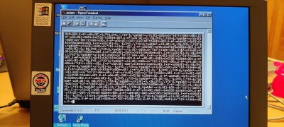

Hey Folks,
I think I need a little push into the right direction. I am missing something.
I have tried with
Code: Select all
screen /dev/ttyUSB0 9600
as well as with cutecom and minicom on linux, but everytime I just get this somewhat scrambled output. (Data bits: 8, Stop bits: 1, HW/SW handshake: off, Parity: None)
Example:
Code: Select all
IKL\0xe9\0xd4!/%\0xa39!%\0xbfq5-15\0x1b\0xbfy!\0x15#\0x175\0x1b\0xbf\0x9d\0xa3\0x9f\0x9f\0xe5\0xeb/\0x17\0x17\0x1f\0x8b\0xa1\0xa1%-1/\0x17
!/%\0xa39!%\0xa115-15\0x1b\0xe5\0xeb\0x00^\0x95u\0xfb\0xfb\0xa7\0xbfy_e\0xa7\0xbf\0x9f\0xa7\0xbf\0x15Y\0x13\0xa1/\0x1b\0xa7\0xbf\0x9f\0xa3\0x9f\0x9f\0xa7\0xbfYgaQ\0xe5\0xeb\0x00^\0x95u\0xfb\0xfb\0xa7\0xbfy_e\0xa7\0xbf\0x9f\0xa7\0xbf\0x15Y\0x13\0xa1/\0x1b\0xa7\0xbf\0x9f\0xa3\0x9f\0x9f\0xa7\0xbfYgaQ\0xe5\0xeb\0x00^\0x95u\0xfb\0xfb\0xa7\0xbfy_e\0xa7\0xbf\0x9f\0xa7\0xbf\0x15Y\0x13\0xa1/\0x1b\0xa7\0xbf\0x9f\0xa3\0x9f\0x9f\0xa7\0xbfYgaQ\0xe5\0xeb\0x00^\0x95u\0xfb\0xeb\0xa7\0xbfy_e\0xa7\0xbf\0x9d\0xa7\0xbf\0x15Y\0x13\0xa1/\0x1b\0xa7\0xbf\0x9f\0xa3\0x9f\0x9f\0xa7\0xbfYgaQ\0xe5\0xeb\0x00
The above output appears when the Geiger-Board is switched on.
It looks to me like there is something wrong with the encoding/decoding, but at the moment I just have this one computer (Ubuntu) available for testing. But since I get regular (around every sec) another "line" of this I guess the connection is setup correctly.
Can anyone give me a hint what I am doing wrong?
