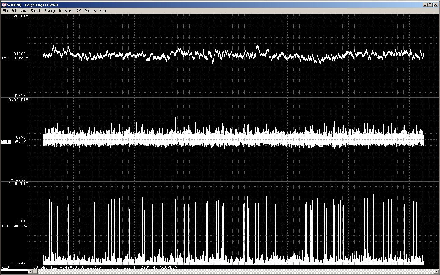

I have now done a completely analog approach to this. The pulses are dumped via Schottky diodes into 3 RC integrators providing 3 different averaging outputs. 1 sec, 1 min, 2 hours. The 1 sec integrator provides instantaneous up and a decay down. So the 1 sec output shows ray showers VERY clearly because they come with bursts very close together in time.

I did not expect all this attention to engineering was going to be required for a device that produces fixed voltage pulses. I discovered that even small amounts of noise raised self counts. Good regulation produced a more stable number of pulses per minute.
I ended up using a Dataq 14 bit A/D datalogger hooked to the 3 integrators.
Im using 3 x SI-22G tubes.
This is about 2 days of logging.

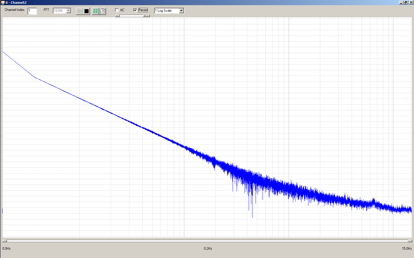

I also looking at Spectra of the background.. Im seeing small, but consistant, deviations from the expected 1/f spectrum.
I can't find any information on the spectrum of background..
