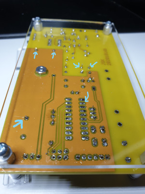

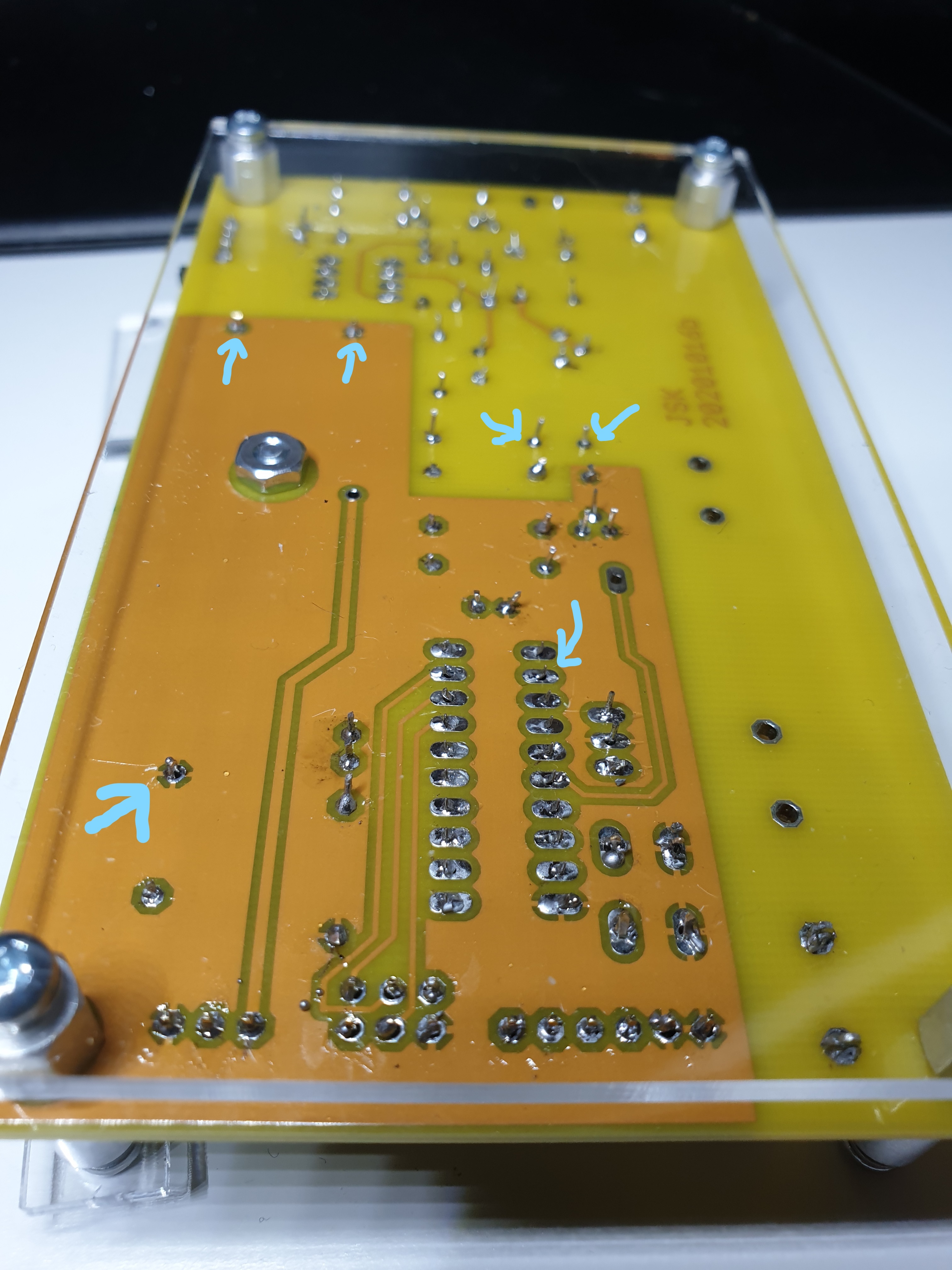

Problem solved:
Problem was bad soldering spots. I fixed the one on the picture. Greetz
