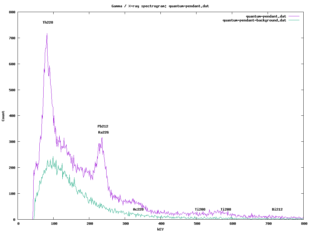

On eBay you can find “alternative health” devices under the terms “Quantum pendant” or “scalar energy” – they’re discs made of some sort of lava rock, and are said to emit negative ions and be beneficial to health in all sort of mystical-sounding ways. The “negative ions” are almost certainly betas from radioactive decay. I got one of these “Quantum Science” discs, with a serial-numbered “scalar energy FIR card” for under $3 delivered. On my MightyOhm it reads out at roughly 3x background. On my homebrew scintillation analyzer with a small NaI crystal it gives around 15 CPS (background is 5-6 CPS) and the gamma spectrum shows a beautiful thorium line at 84 kEV and lead and radium lines at 238-241 kEV. I would not personally wear one of these next to my skin!
Spectrum plot (sample, and background) is at http://www.radagast.org/~dplatt/geiger/quantum-pendant.png
